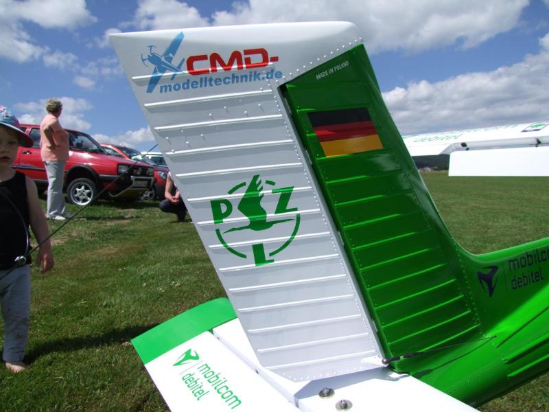

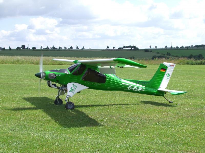

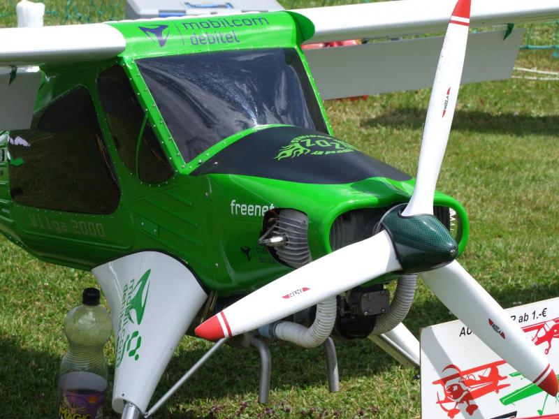

Obiecane fotki modelu Wilgi 2000 Gillersdorf 2015
