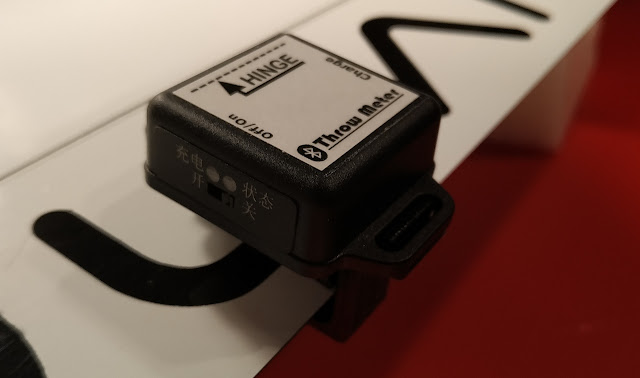

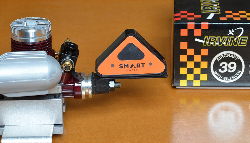

RomanJ4 Opublikowano 19 Lutego 2022 Opublikowano 19 Lutego 2022 15 godzin temu, RobRoy napisał: bo mój wujek G... jakiś mało kumaty ... Podobne https://planet-soaring.blogspot.com/2019/02/make-your-own-bluetooth-rc-throwmeter.html https://images-na.ssl-images-amazon.com/images/I/A10tcv17qcL.pdf https://planet-soaring.blogspot.com/2019/02/make-your-own-bluetooth-rc-throwmeter.html https://wordcraft.com/smartangle/about/overview https://planet-soaring.blogspot.com/2018/04/review-digital-throw-meter-from.html https://www.ckaero.net/collections/featured-products/products/lightweight-magnetic-mount-for-angle-pro-throw-meter i wielofunkcyjny AnglePro 4-in-1 Digital Throw/Incidence Meter https://www.spektrumrc.com/Products/Default.aspx?ProdID=HAN192 https://www.horizonhobby.com/product/anglepro-ii-5-in-1-digital-throw-incidence-meter/EFLA280.html Kto lubi podłubać... https://www.rcgroups.com/forums/showthread.php?3025585-Aaro-s-inclinometer/page2
