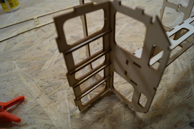

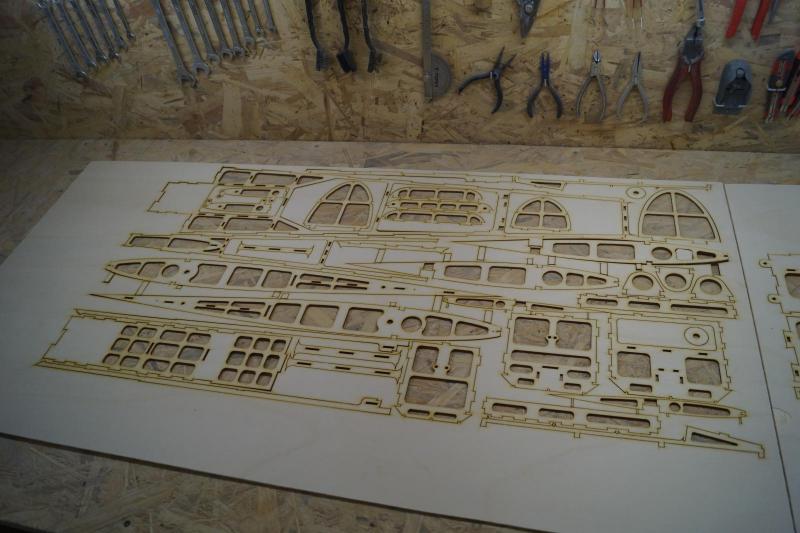

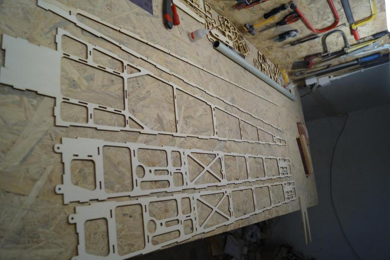

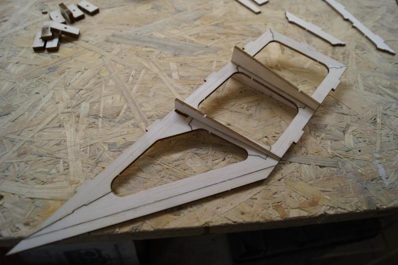

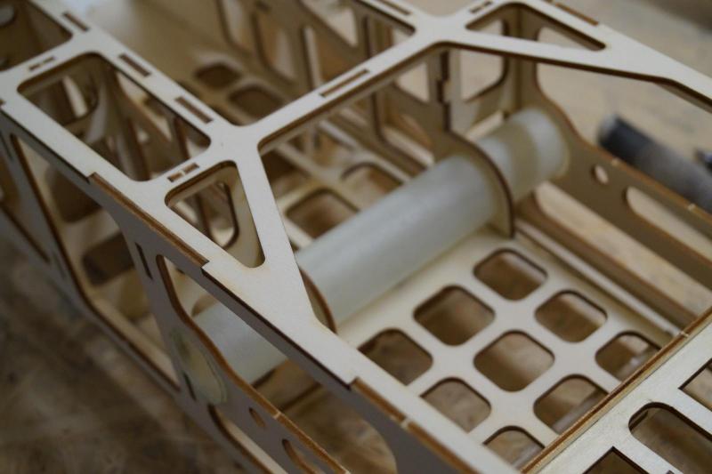

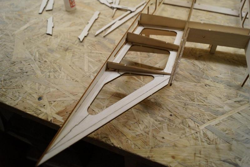

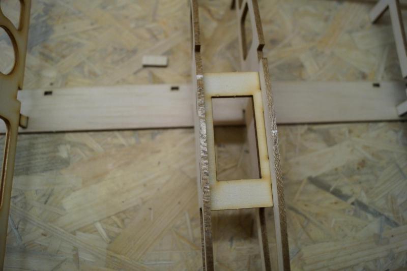

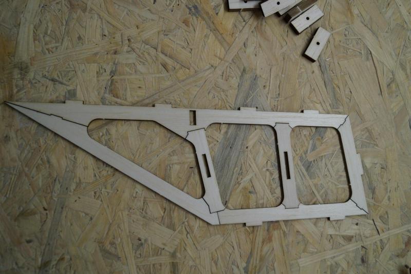

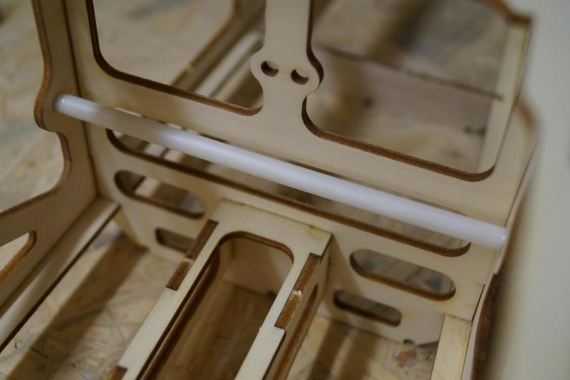

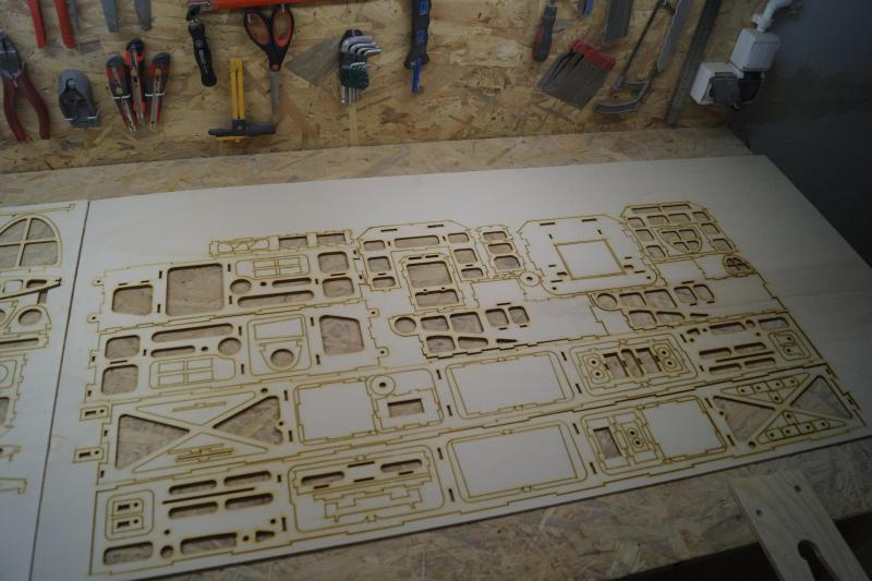

ELEMENTY ZE SKLEJKI

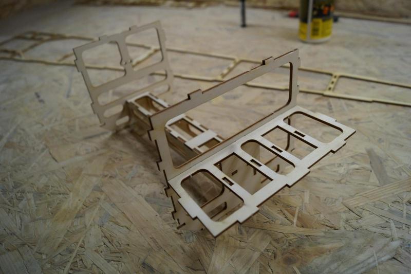

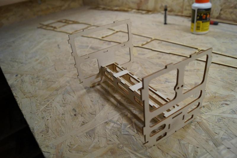

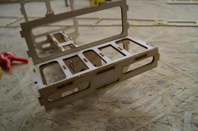

SKLEJAMY SEGMENT SERW
SKLEJAMY BOKI KADŁUBA

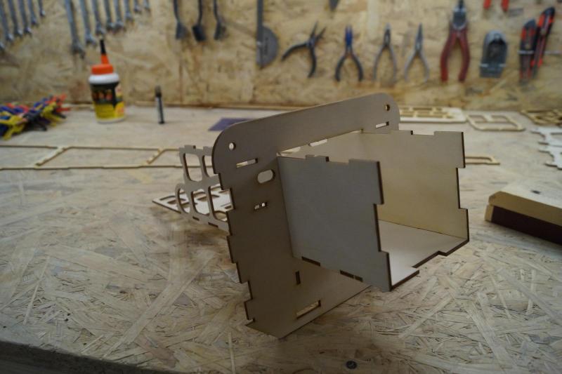

NA SUCHO BEZ KLEJU SKŁADAMY DOMEK SILNIKA

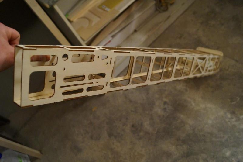

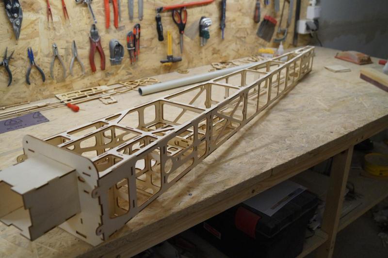

NASTĘPNIE NA SUCHO SKŁADAMY CAŁY KADŁÓB
NA TYM ETAPIE MOŻNA WSZYSTKIE POŁĄCZENIA POZALEWAĆ CA
WKLEJAMY BALSOWE PÓŁWRĘGI Z DOŁU KADŁUBA

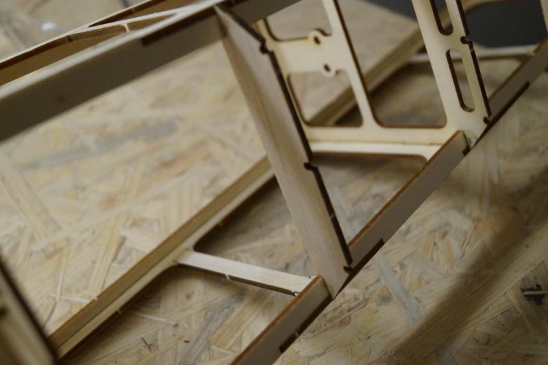

WKLEJAMY KIESZEŃ BAGNETOWĄ I RURKĘ PROWADZĄCĄ KOŁKI STABILIZUJĄCE SKRZYDŁA

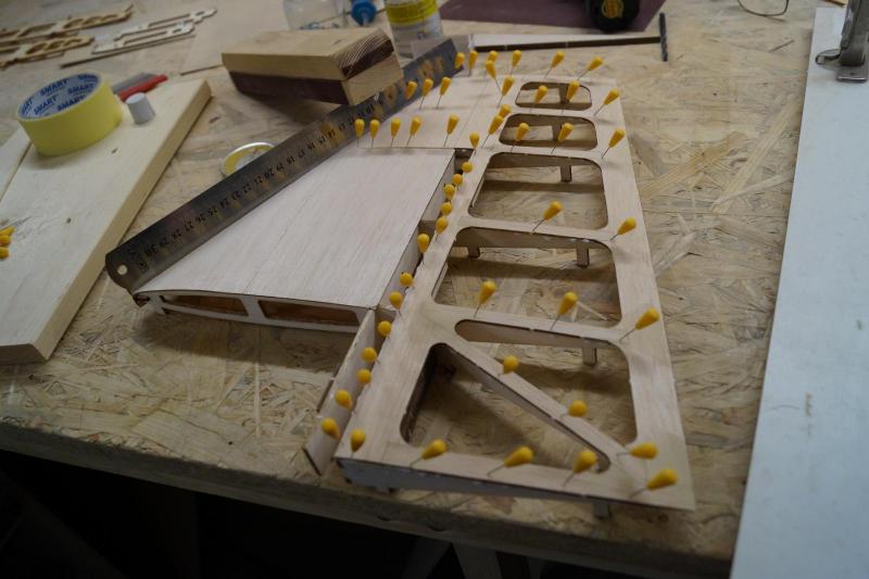

MIĘDZY CZASIE CZEKAJĄC NA DOSTAWĘ PRĘTÓW WĘGLOWYCH I DZWIGARÓW WZIĄŁEM SIĘ ZA USTERZENIE PIONOWE

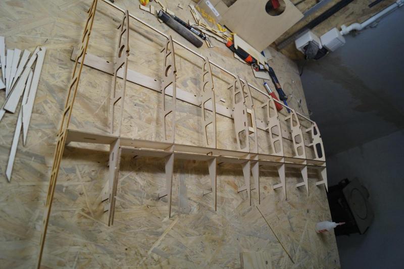

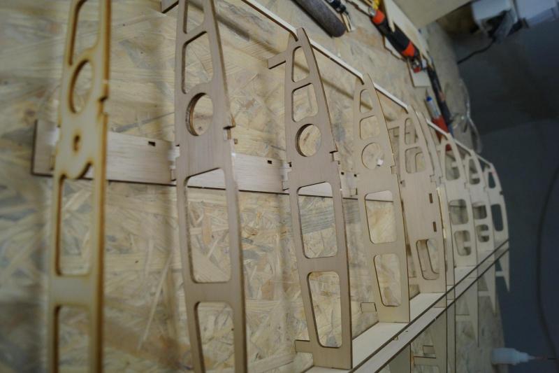

NA TAPETĘ POSZŁO TEŻ SKRZYDŁO,
NA TERAZ BĘDZIE PEWNIE ZE 3 DNI PRZERWY BO CZEKAM NA DOSTAWĘ  PRĘTÓW WĘGLOWYCH I LISTEW SOSNOWYCH 8 X 4 NA DZWIGARY
